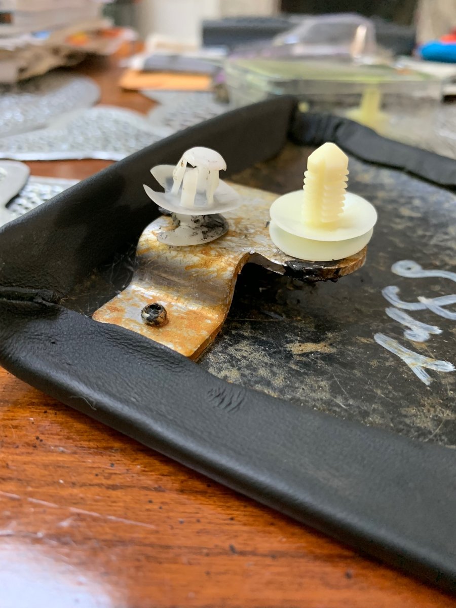

chucklehead Report post Posted August 1, 2019 Trim fastener door autozone GM Body Trim Panel Retainers #467380 original fastener on left, replacement right different shape but works nice Quote Share this post Link to post Share on other sites More sharing options...
Houston Report post Posted August 1, 2019 13 hours ago, chucklehead said: Trim fastener door autozone GM Body Trim Panel Retainers #467380 original fastener on left, replacement right different shape but works nice chucklehead, thanks for sharing. I encountered this a few months ago and went with the high $$ factory retainers. Good to know for future work. Quote Share this post Link to post Share on other sites More sharing options...
frank7746 Report post Posted August 3, 2019 The factory retainers are only $.80 cents each Hope this helps Quote Share this post Link to post Share on other sites More sharing options...
